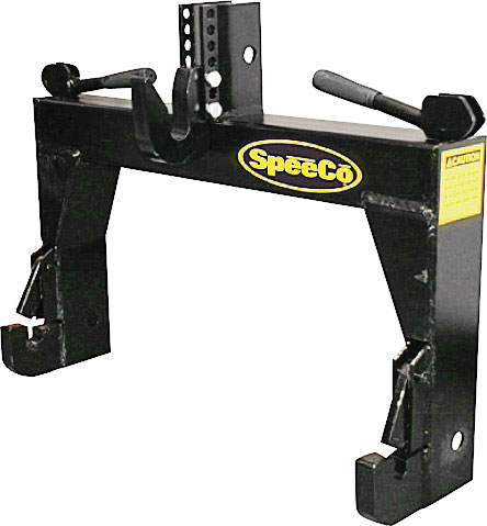

To understand how the latch works look at the quick hitches on the Land Pride website. Only the bottom links have a latch. The top just a hook. For Canada I suggest contacting the dealers. They should know of a source.
Landpride quick hitches are not the same design at all. The inverted U-frame style sold by Speeco and Landpride and others is often unpopular with folks who have tried to adopt it. I've never met anyone who really likes it though I frequently see one leaning up against a shed wall.
