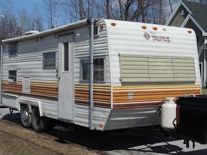

Housing I went out and bought an old 24' foot camper, which is about 8 feet wide, which gives me 5.6 birds per m2. Should I make part of the floor mesh or slated? This would make cleaning easier, but a solid floor keeps the heat in a lot better during our chilly winters. I can imagine parking the egg mobile inside a hoophouse in the winter, if we had the space. Our current greenhouse is usually full of crops year round. Other options?
Fencing I plan to use electric poultry netting in the style of Harvey Ussery, so I will need a power source. I was planning to use a 12v charger for the electric fence, a marine battery and a solar panel. This will also give me 12v power for other aspects of the eggmobile (e.g. I can turn on the lights in the camper!). I am looking for input on size of solar panel, size of battery and a good 12 volt charge. I am guessing I need a charge controller too. I also like the camper for this reason, because in the winter I can park it near the barn and plug it in and I will have 12 volt for the fence charger and 120 volts for heat lamps.
