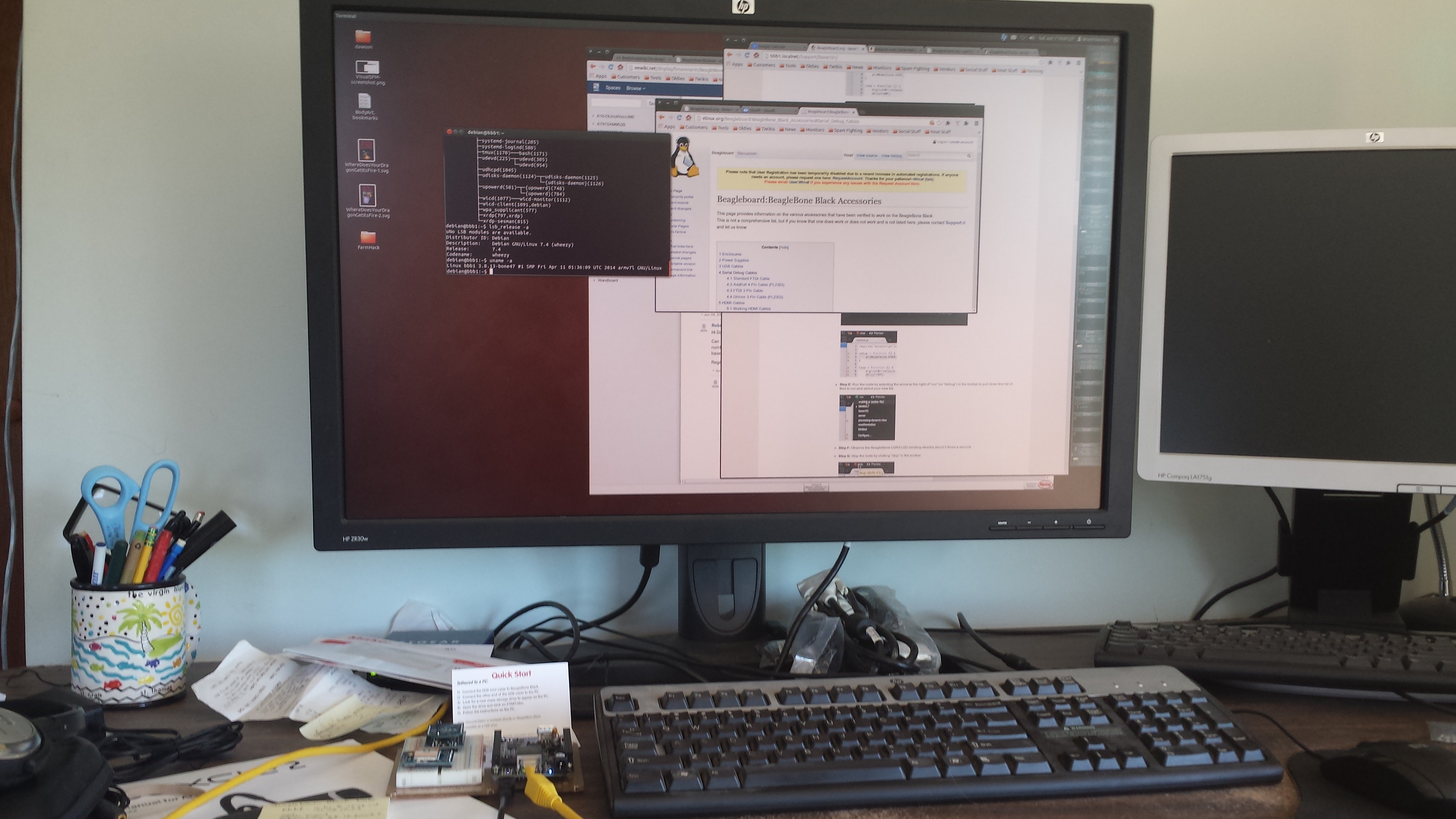

In the image, the BBB is to the left of the keyboard below the screen - you might be able to see one of the blue lights as it flashes. The screen has the following windows on it: * Terminal window - this is logged into the BBB and shows the stock OS version and the tail end of a hierarchical process list. * Several web browser windows that are opened to the BBB on the desk, the eewiki web site, and the BeagleBone site. At the moment, these are my primary reference sites.
