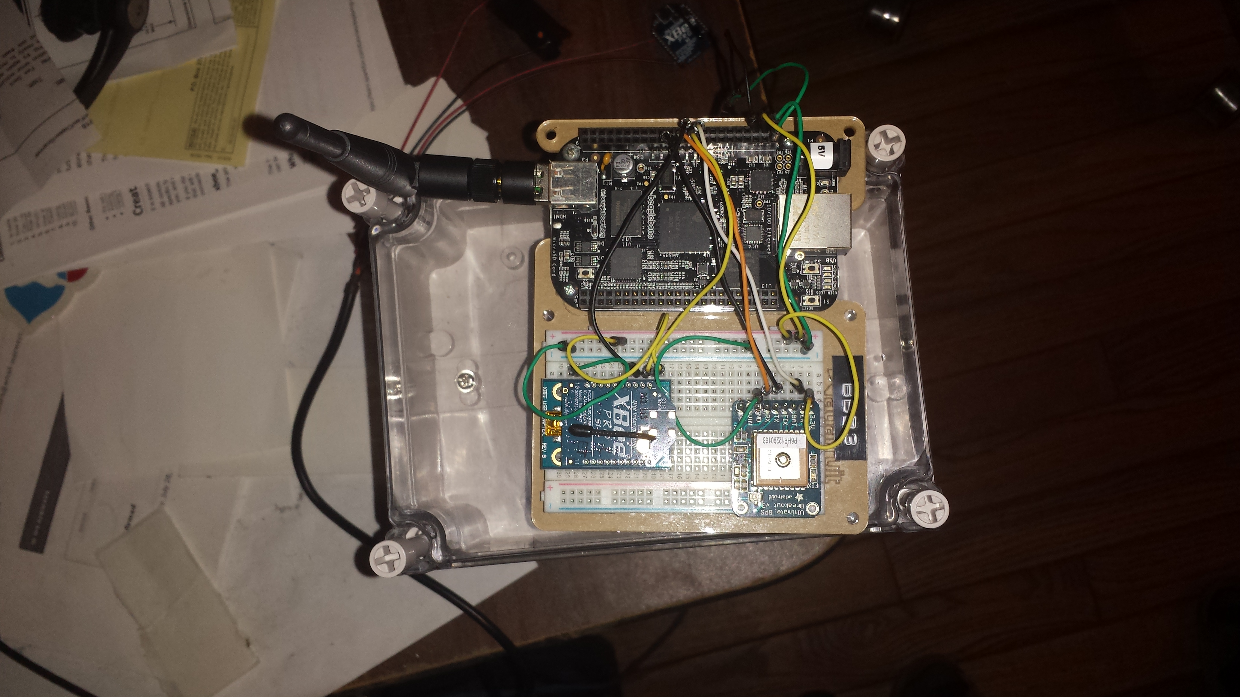

Well, I've got 3 base stations and 5 ear tags working. Still waiting for nickel & dime hardware (connectors for batteries, boxes, ...)
The base station software is 95% complete - all that's left is (maybe) coding the failover logic when we lose wi-fi access and including the time-of-flight numbers for each ear-tag (even though it will be wrong).
Also, configuration of the system is non-trivial, so I'll probably have to code some auto-configuration logic into the system - but not before the end of the month.

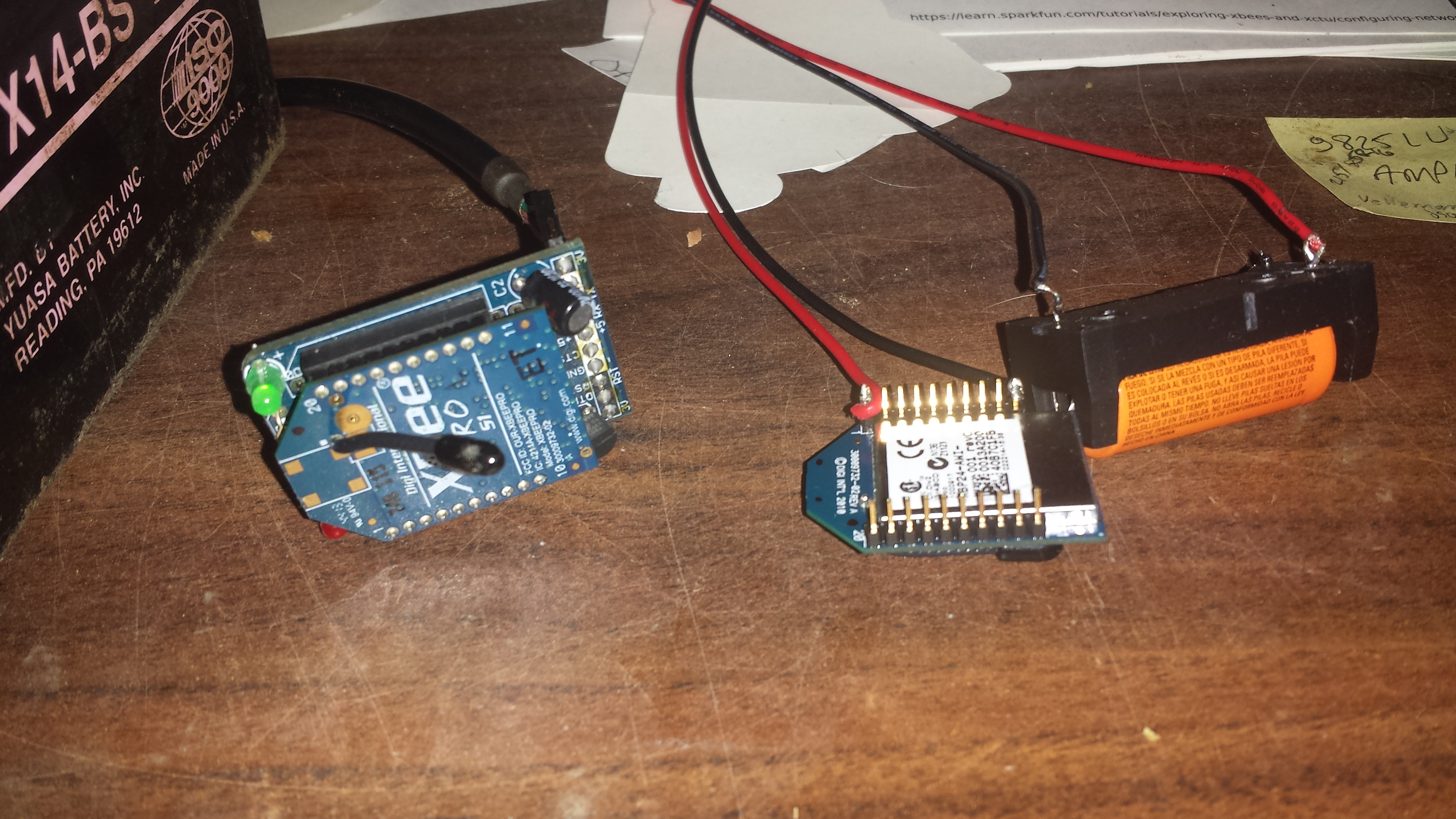

The ear tags are a lot heavier than I wanted; the batteries are over 2/3 of the weight, but I wanted 1 mile distance between tags, and that consumes a lot of "juice". I may be able to conserve power by setting sleep intervals for the tags, but not in the first release!
Otherwise the base stations and "ear tags" are ready for outdoor testing. I just have to cut holes in the boxes and shrink wrap the ear tags. Then we can do some testing - so probably not until next weekend!
I expect to publish all the code and do presentations in January 2016. And maybe do some documenting...
The images are of a base station (out of the white weather-proof enclosure), and a top view of the base station. The last picture is of the "ear tag" transceivers - left one is a debugging connection hooked up to the computer, and the right one (with battery) will be shrinked-wrapped and applied to an ear tag.
