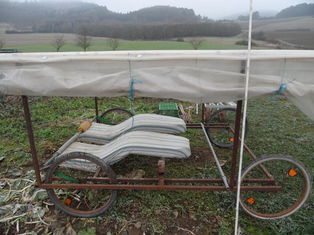

  1. Human Powered Prone Weeder "Hufmann" found in a CSA in Germany:

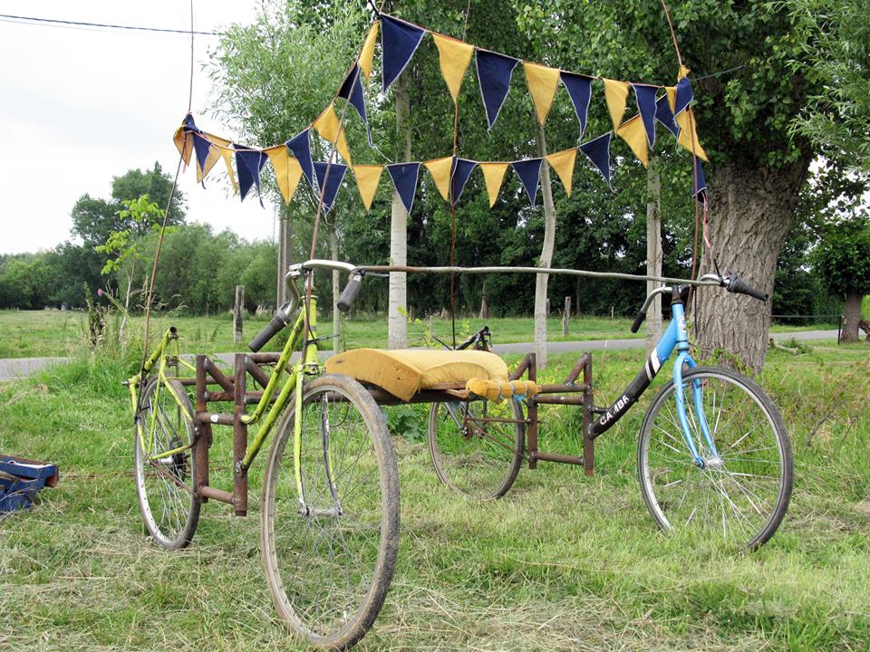

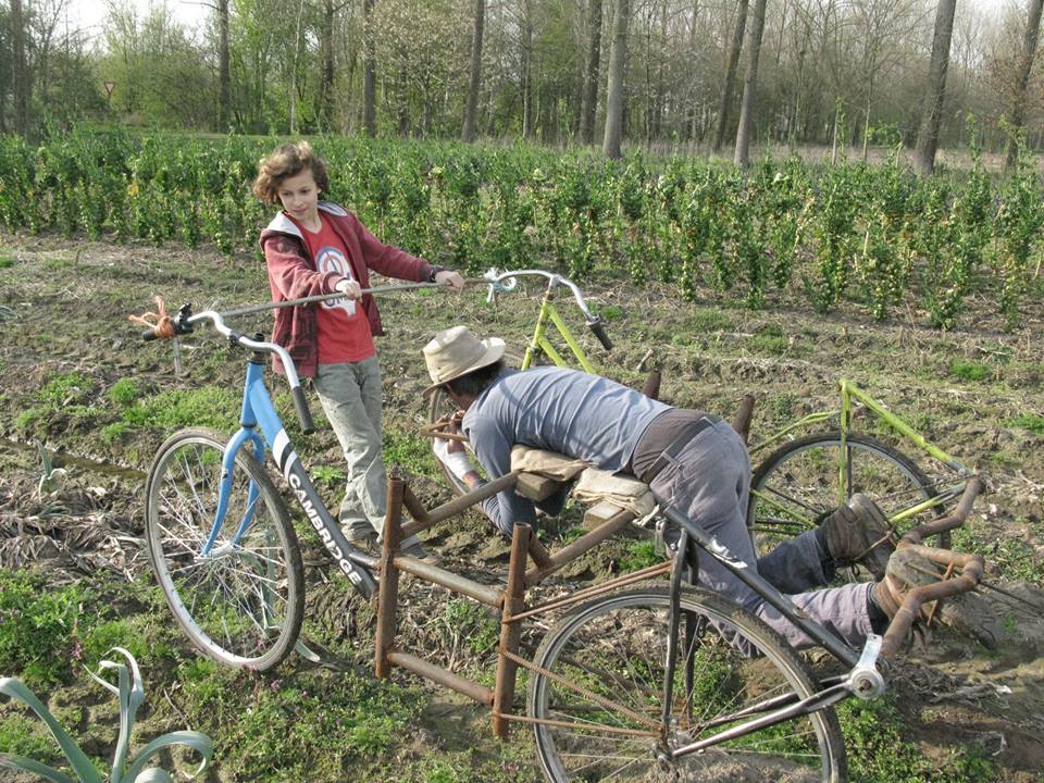

  2. The ideas from "Fietsenwieders", Antwerpen (link is external) especially interesting Model JustInTime:
    Pitily I did not succeed to upload a video from their promising Version "Unidentified Flying Object" due to their f***book-based dissemination. See my owncloud link below for further information.

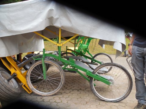

  4. The Berrypicker:

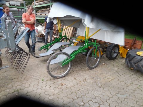

  5. The Lazy Weeder:

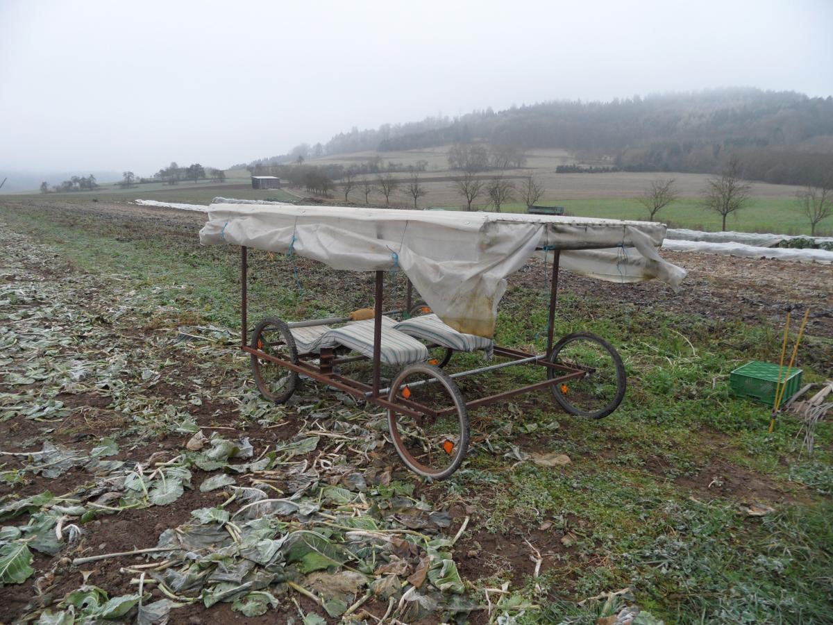

  6. One german intuitive construction:
  7. and another:
