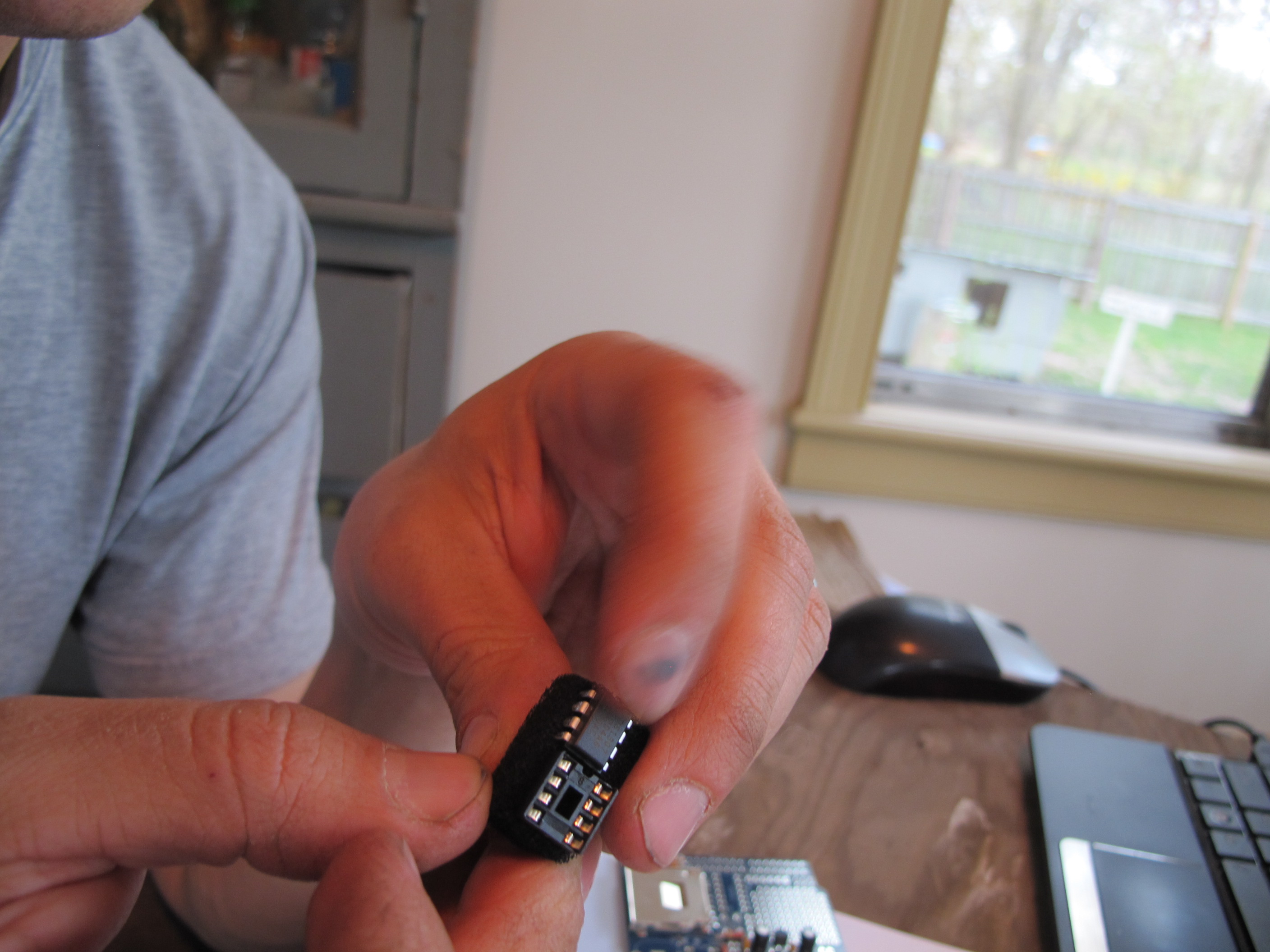

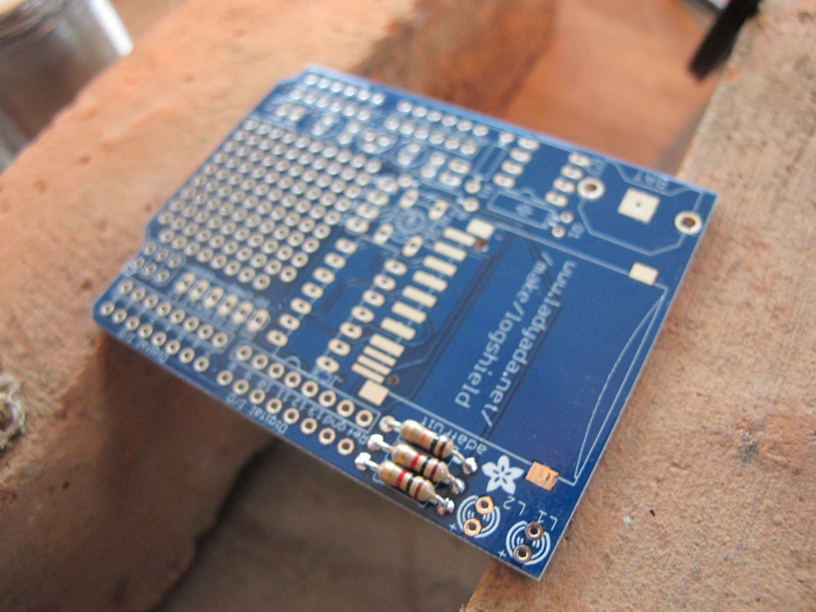

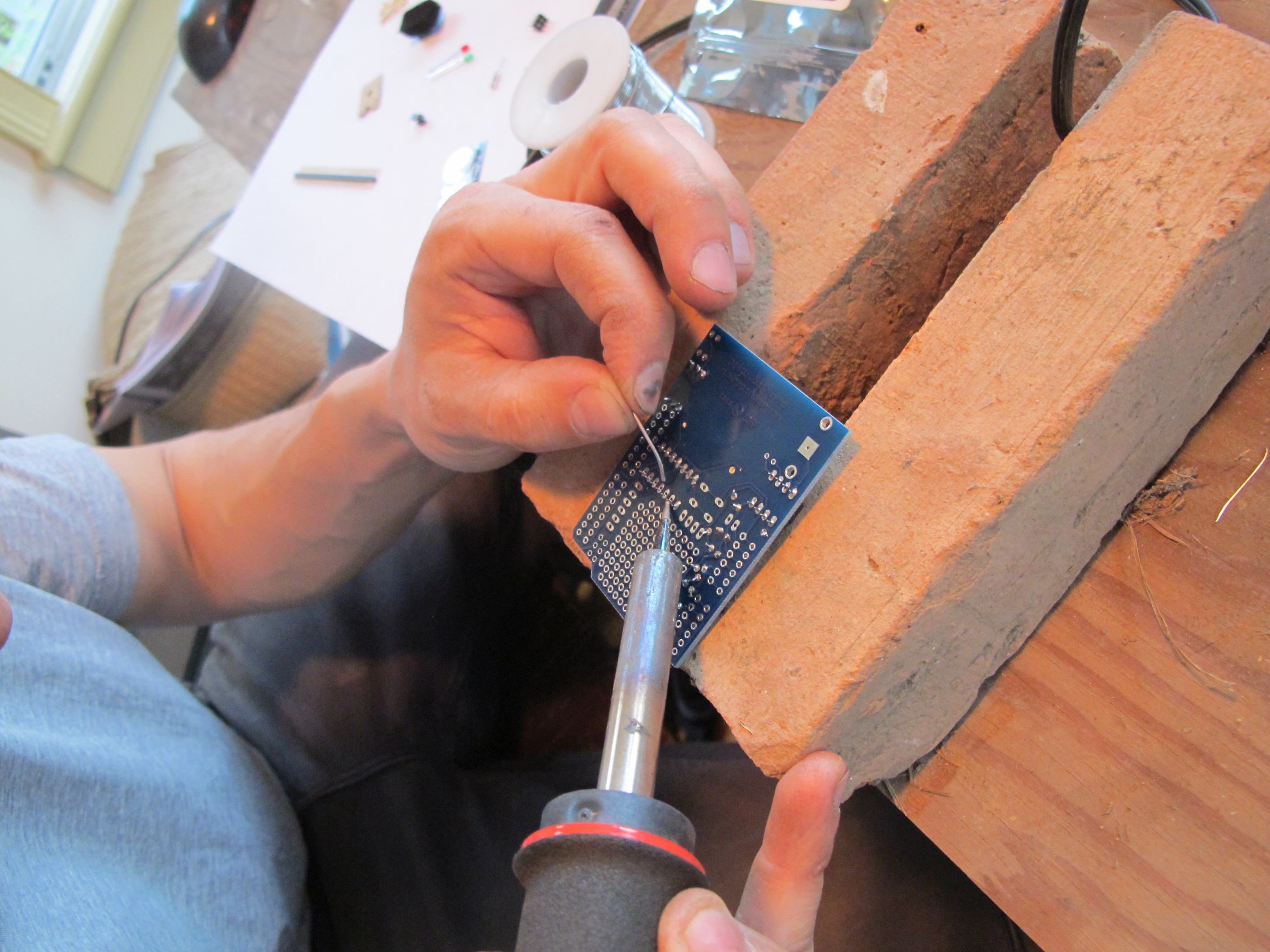

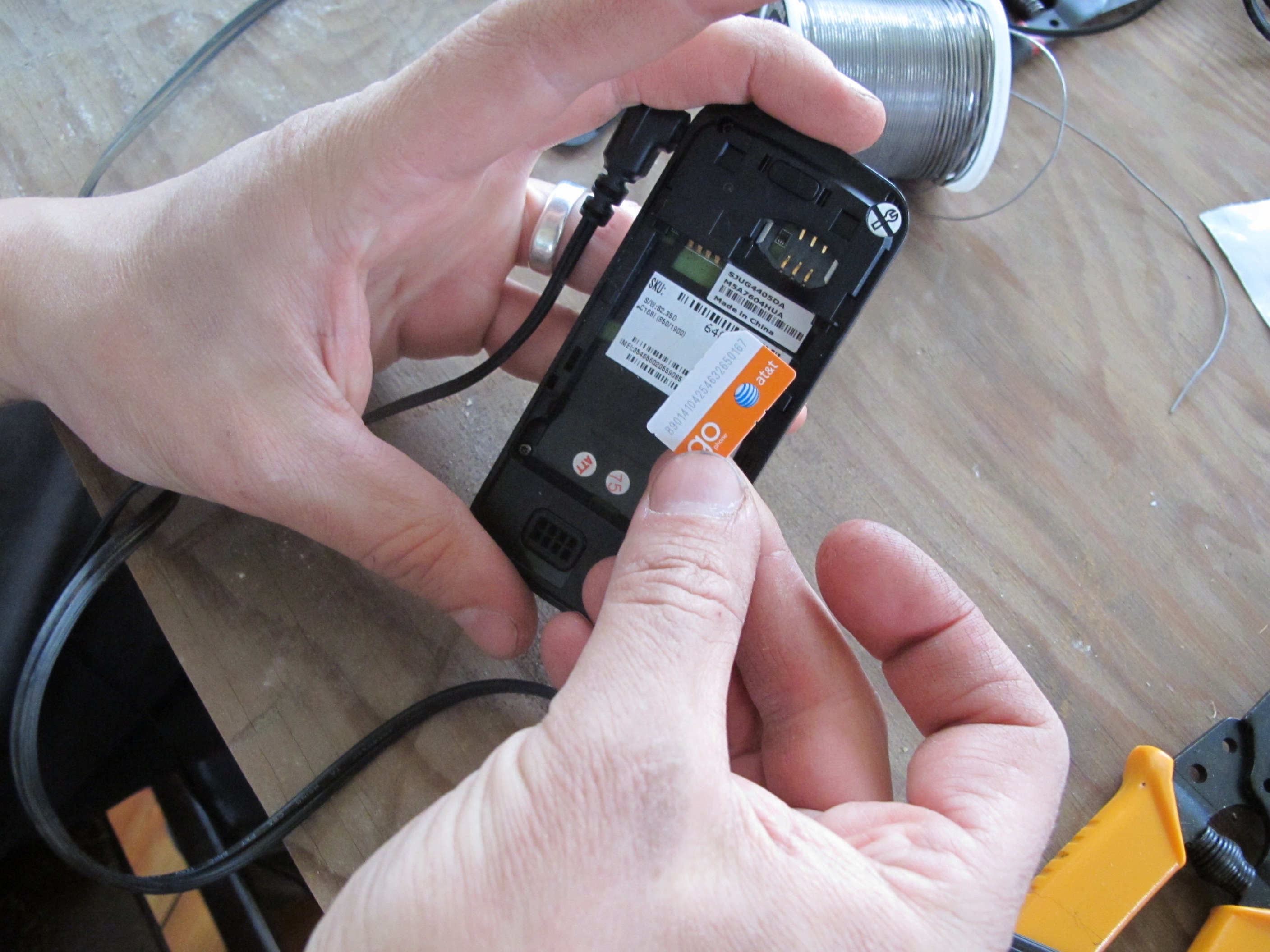

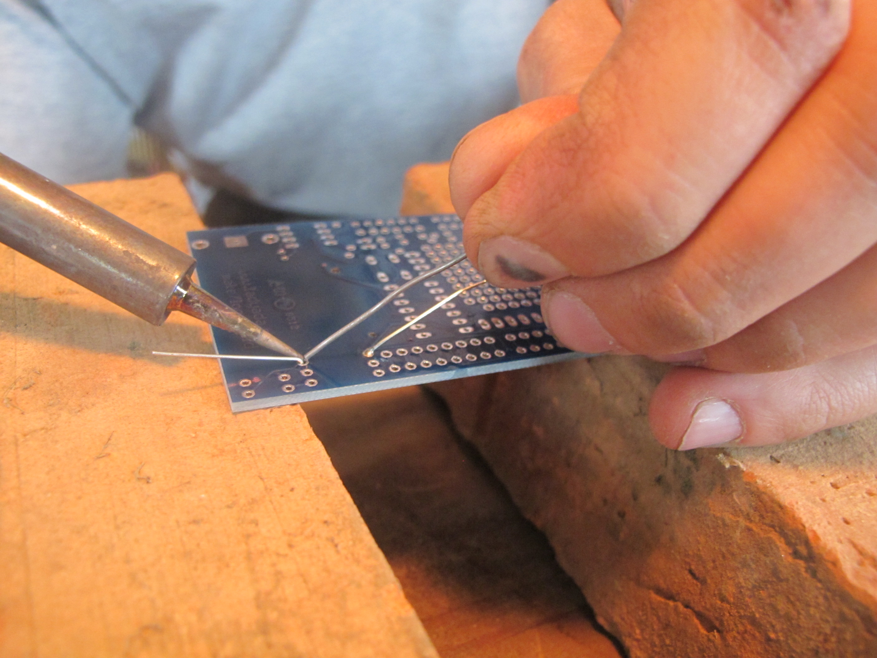

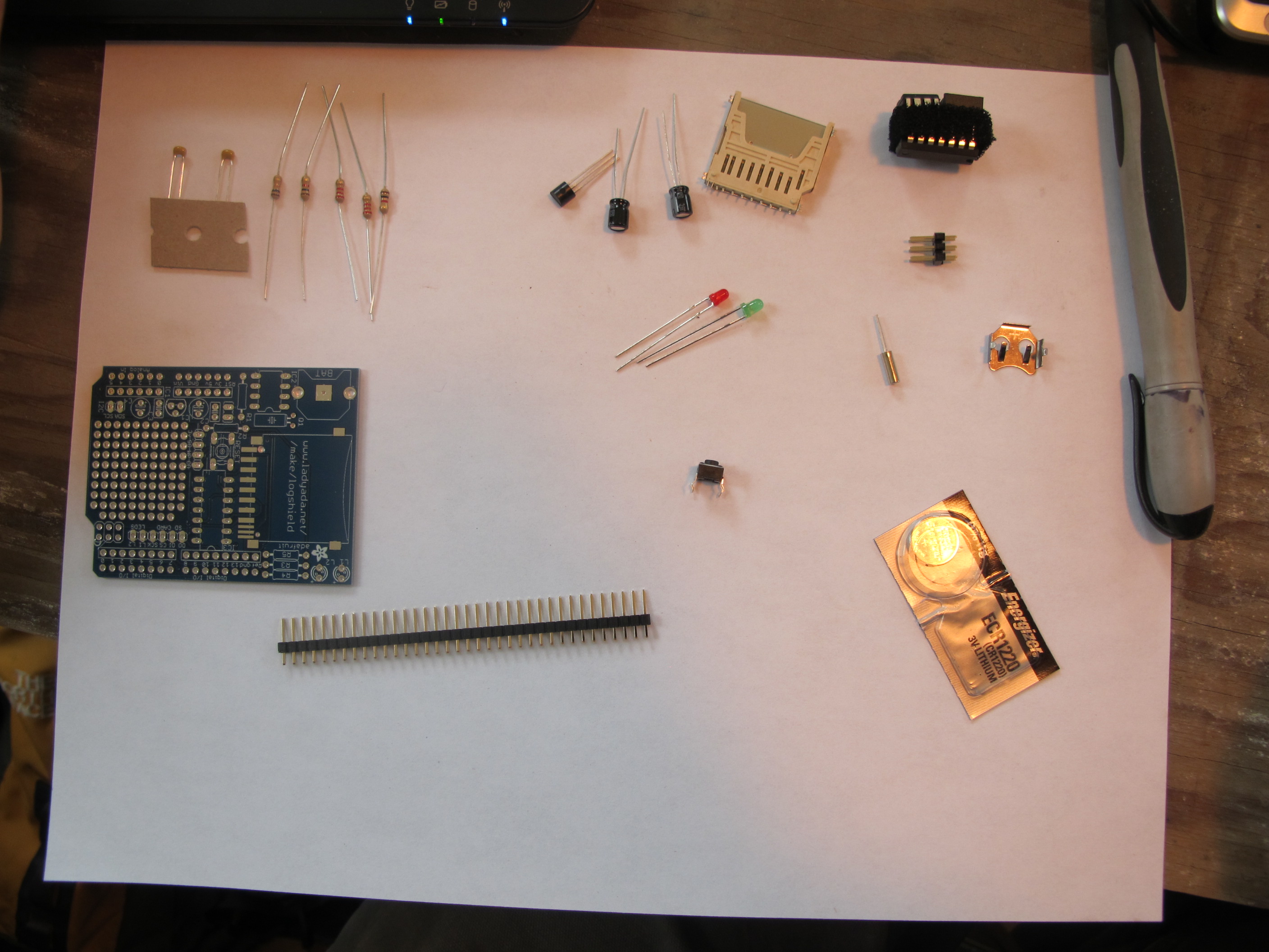

On Sunday April 15, 2012 Loius Thiery and I travelled to the Hudson Valley to observe Benjamin Shute build a Fido for a greenhouse on his farm, Hearty Roots. Our end goal is to create a device design and documentation accessible enough for farmers to build Fido themselves. We all knew beforehand that we had not reached our goal yet but we saw value in a trial run to see what we might learn to help direct our design and documentation efforts. During the build we took feedback and photographed Ben's progress. The feedback resulted in Louis making many on the fly documentation changes. While we did not have enough time to complete the build (we ran into some bugs, more to come on that), Louis and I will continue to work with Ben and continue developing the Fido design.
I've attached the photos from our build day to this forum topic and I've also written up some questions for Ben and Loius to be answered in the comments below.

Now that the code has been slimmed down to actually fit onto the Arduino, my biggest challenge is the cell phone. The Arduino and the cellphone talk at different voltages and I think that that is the origin of the current inconsistencies in behavior.
What do you think your next two steps will be developing the design for Fido?
Currently, a voltage divider brings the Arduino's 5V down to 3.3V. This does the trick but I think makes the device very fickle. I am going to try to do the same connection with a chip called a logic shifter instead and see if that resolves the issue. If it fails, then I'll know that there is a fundamental issue in the library I wrote for the cell phone and I will try tweaking that again

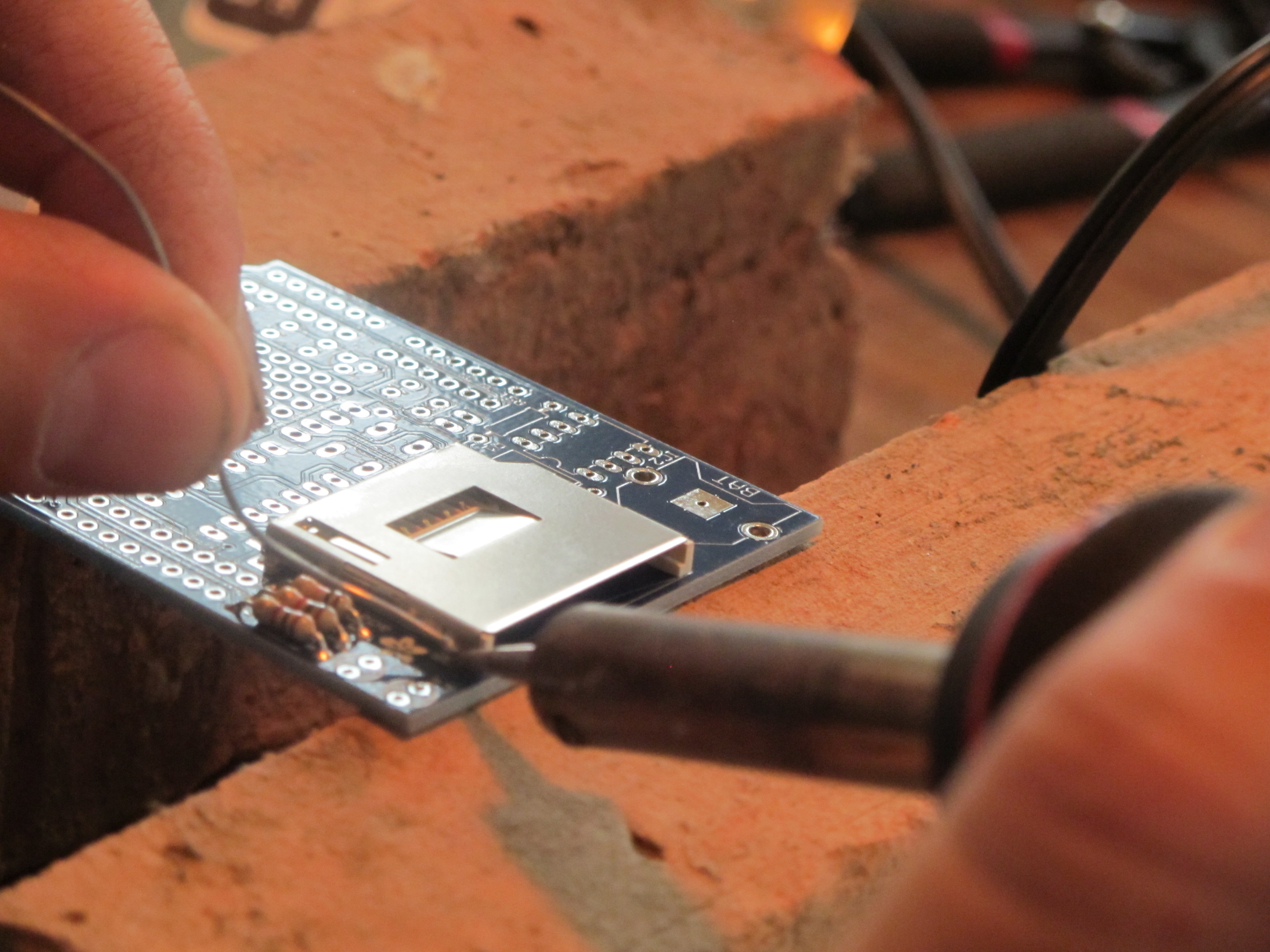

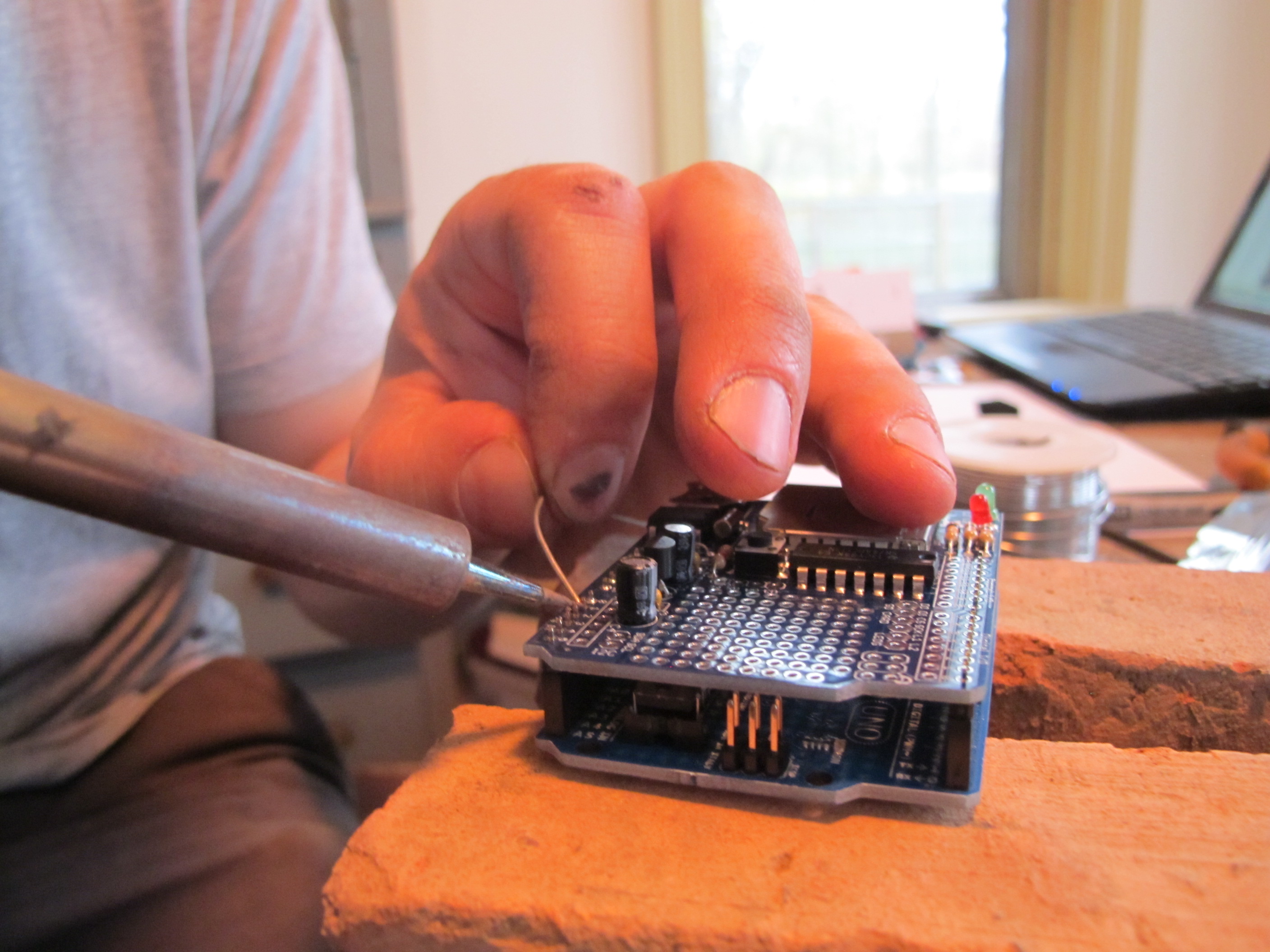

I was worried the the actual soldering of the circuit board would be challenging, and that I would mess something up. It turned out to be no problem and was actually fun. I found it difficult to completely understand the nuances of the circuitry and why I was soldering what things where-- but as long as there are clear diagrams, the farmer can choose whether or not to pursue understanding the theory, but still end up with a working tool.

Also, I've running Fido with a logic shifter currently and the communication runs a lot more reliably now. I will be running Fido all week and will hopefully have a fairly stable program ready for this weekend!
